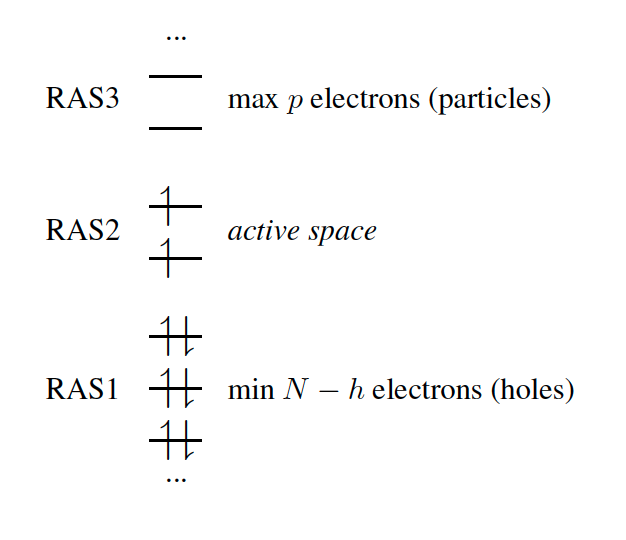

In the RAS formalism, one divides the orbital space into three subspaces called RAS1, RAS2 and RAS3 (Fig. 7.2). The RAS-CI states are defined by the number of orbitals and the restrictions in each subspace.
Orbital subspaces in RAS-CI employing a ROHF triplet reference.
Figure 7.2: Orbital subspaces in RAS-CI employing a ROHF triplet reference.
