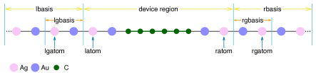

Illustration for the different regions of the molecular junction for
Landauer calculation.
Figure 13.1: Illustration for the different regions of the molecular junction for Landauer calculation.

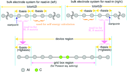

NEGF calculation.
Figure 13.2: Illustration for the different regions of the molecular junction for NEGF calculation.

For the NEGF calculation, trans_lbasis and trans_lgbasis must be the same number as shown in Fig. 13.2 (also for trans_rbasis and trans_rgbasis). The NEGF calculations require precalculated bulk data, while the Landauer can use such precalculated data as an option.
The example in Fig. 13.1 includes a total of 18 atoms, where the Au and Ag basis sets each contain 22 basis functions per atom. The repeat unit includes a pair of Au Ag atoms. Therefore, the parameters should be given as follows (only the first two columns are required, the rest are included for explanation):
trans_lbasis 88 No. of functions representing left electrode region (2×22 for Ag + 2×22 for Au)
trans_rbasis 88 No. of functions representing right electrode (2×22 for Ag + 2×22 for Au)
trans_lgbasis 44 Size of the repeating unit of the left electrode (22 for Ag + 22 for Au)
trans_rgbasis 44 Size of the repeating unit of the right electrode (22 for Ag + 22 for Au)
Alternatively this section can be based on the atom numbers corresponding to their position in the $molecule section:
trans_lgatom 3 Third atom is used to define the repeat unit of the left electrode
trans_latom 5 Fifth atom is the first atom of the junction
trans_ratom 14 Fourteenth atom is the last atom of the junction
trans_rgatom 16 Sixteenth atom is used to define the repeat unit of the right electrode
In this example, we have used the same repeat unit for the left and right electrodes; this symmetry is not required.

       If set to 1, the following files are requred: FAmat2l.dat and Smat2l.dat (for left electrode model), FAmat2r.dat and Smat2r.dat (for right electrode model). If both electrodes are of the same type, may use symbolic links to the same files. (For unrestricted spin model, FBmat2l.dat and FBmat2r.dat are also necessary)
For trans_readhs = 1, the paramters for parsing the precalculated bulk matrices ( FAmat2l.dat, etc) have to be provided. These indices define the regions within the bulk full model space to set the onsite and coupling matrcies for the SE calculations.
    trans_totorb2 (Integer):
    Total number of basis functions in the electrode models (if set, then same size is assumed for both electrodes) (no default value).
    trans_totorb2l: Integer number, total number of basis functions in left electrode model (no default value).
    trans_totorb2r: Integer number, total number of basis functions in right electrode model (no default value).
    trans_startpoint: Integer number, start point (basis number) for reading the TB integrals. Note, the basis number, that is, index number of basis function starts from 0. (if set, then same size is assumed for both electrodes) (default value 0).
    trans_startpointl: given as integer number, left start point (basis number) for reading the TB integrals. Note, the basis number, that is, index number of basis function starts from 0. (default value 0).
    trans_startpointr: given as integer number, right start point (basis number) for reading the TB integrals. Note, the basis number, that is, index number of basis function starts from 0. (no default value).

As an example of the Landauer calculation, the sample Q-Chem input is given below.
Example 13.3  Quantum transport Landauer calculation applied to C6 between two gold electrodes.
   Ag   -11.000    0.000  0.000
   Au    -8.300    0.000  0.000
   Ag    -5.600    0.000  0.000
   Au    -2.900    0.000  0.000
   Ag    -0.200    0.000  0.000
   Au     2.500    0.000  0.000
   C      4.800    0.000  0.000
   C      6.500    0.000  0.000
   C      8.200    0.000  0.000
   C      9.900    0.000  0.000
   C     11.600    0.000  0.000
   C     13.300    0.000  0.000
   Au    15.600    0.000  0.000
   Ag    18.300    0.000  0.000
   Au    21.000    0.000  0.000
   Ag    23.700    0.000  0.000
   Au    26.400    0.000  0.000
   Ag    29.100    0.000  0.000
   METHOD            B3LYP
   BASIS             lanl2dz
   ECP               lanl2dz
   ECP_FIT           true
   INCDFT            FALSE
   MOLDEN_FORMAT     TRUE
   SCF_CONVERGENCE   6
   TRANS_ENABLE      1
$trans-method
   trans_spin        0
   trans_npoints     300
   trans_method      0
   trans_readhs      0
   trans_printdos    1
   trans_efermi      -6.50
   trans_vmax        4.00
$trans-model
   trans_lgatom      3
   trans_latom       5
   trans_ratom       14
   trans_rgatom      16

As preparation for the next step, the following setups are necessary:
  1. 1.
    The files FAmat2l.dat, FAmat2r.dat, Smat2l.dat, and Smat2r.dat (also FBmat2l.dat and FBmat2r.dat if the calculation is spin-unrestricted) that link to output dat file of the bulk clculation must be placed in the same directory of the following Q-Chem input file. Coping or linking the output files of the step 1-A.
  2. 2.
    Restart directory of the standard DFT obtained in the step 1-B is used by the SCF_GUESS.
  3. 3.
    (Optional) Read-in electrostatic potential data in "ReadInESP/" directory must be placed if this option is used (for trans_readesp = 1). This option can provide more bulk electrode electrostatic environment as the boundary condition of Poisson equation solving (see the sample files in $QC/samples/tchem) for more details).

   trans_readhs        1
   trans_totorb2      48
   trans_startpointl  16
   trans_startpointr  32
$trans-model
   trans_lbasis   8
   trans_rbasis   8
   trans_lgbasis  8
   trans_rgbasis  8
As preparation for the next step, the following files and directories are necessary:
  1. 1.
    In the same way as step 2, FAmat2l.dat, FAmat2r.dat, Smat2l.dat, and Smat2r.dat (also FBmat2l.dat and FBmat2r.dat for spin-unrestricted calculations) must be placed.
  2. 2.
    Restart directory for Q-Chem generated in the step 2 must be copied to here (only coordinates are used).
  3. 3.
    T-Chem Restart directory "TransRestart/" for density matrix must be created and DAmat.dat (and DBmat.dat for spin-unrestricted) generated in the step 2 must be copied or linked to the directory.
  4. 4.
    Electrostatic potential data in "ReadInESP/" directory used in the step 2 must be copied to here.
  5. 5.
    Set Fermi energy obtained from Step 2 using the trans_fermi (recommended).
