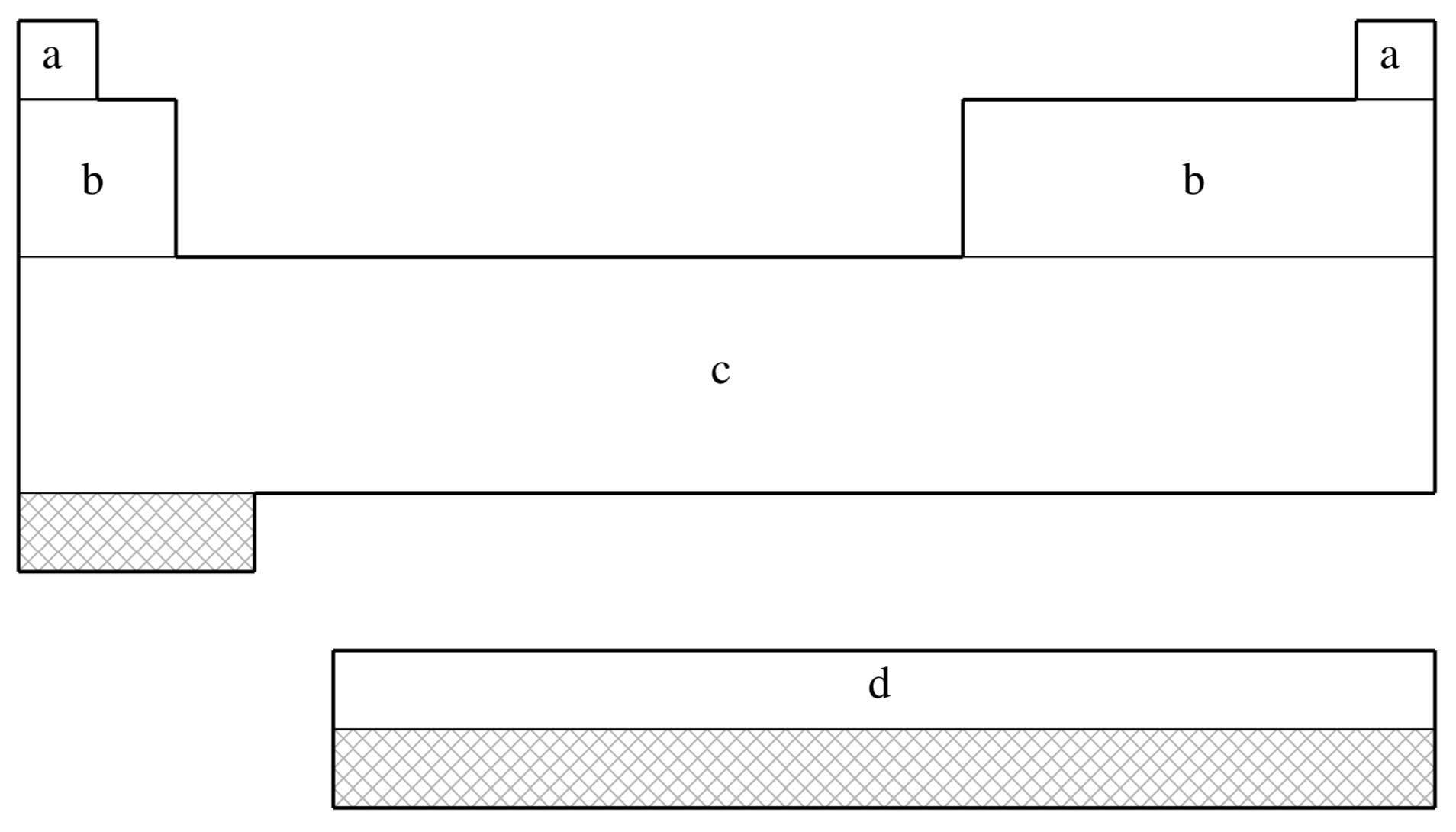

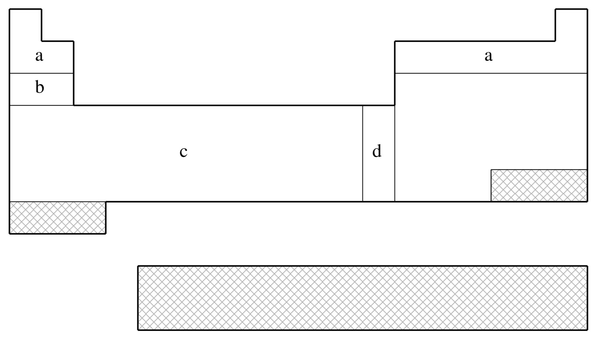

8.10.4.2 The fit-HWMB ECP
fit-HWMB is not available for shaded elements
(a) No ECP; Pople STO-3G basis used
(b) Wadt & Hay (Ref.  1324 Wadt W. R., Hay P. J.
J. Chem. Phys.
(1985), 82, pp. 284.
Link
(c) Hay & Wadt (Ref.  496 Hay P. J., Wadt W. R.
J. Chem. Phys.
(1985), 82, pp. 299.
Link
(d) Hay & Wadt (Ref.  495 Hay P. J., Wadt W. R.
J. Chem. Phys.
(1985), 82, pp. 270.
Link
Element Core Max Projector Valence
H–He none none (1s)
Li–Ne none none (2s,1p)
Na–Ar [Ne] P (1s,1p)
K–Ca [Ne] P (2s,1p)
Sc–Cu [Ne] P (2s,1p,1d)
Zn [Ar] D (1s,1p,1d)
Ga–Kr [Ar]+3d D (1s,1p)
Rb–Sr [Ar]+3d D (2s,1p)
Y–Ag [Ar]+3d D (2s,1p,1d)
Cd [Kr] D (1s,1p,1d)
In–Xe [Kr]+4d D (1s,1p)
Cs–Ba [Kr]+4d D (2s,1p)
La [Kr]+4d D (2s,1p,1d)
Hf–Au [Kr]+4d+4f F (2s,1p,1d)
Hg [Xe]+4f F (1s,1p,1d)
Tl–Bi [Xe]+4f+5d F (1s,1p)
Table 8.10: Supported elements for the fit-HWMB ECP.

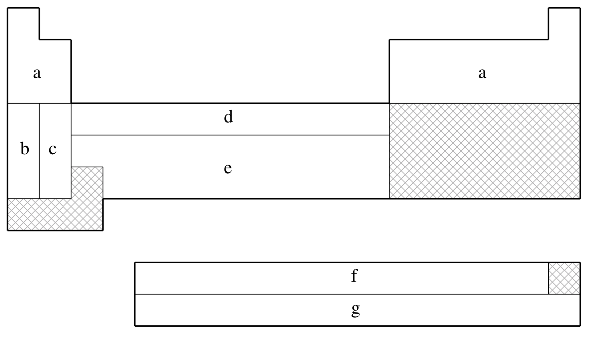

8.10.4.3 The fit-LANL2DZ ECP
fit-LANL2DZ is not available for shaded elements
(a) No ECP; Pople 6-31G basis used
J. Chem. Phys.
Link
J. Chem. Phys.
Link
J. Chem. Phys.
Link
(e) Hay (Ref.  497 Hay P. J.
J. Chem. Phys.
(1983), 79, pp. 5469.
Link
(f) Hay & Martin (Ref.  494 Hay P. J., Martin R. L.
J. Chem. Phys.
(1998), 109, pp. 3875.
Link
H–He none none (2s)
Li–Ne none none (3s,2p)
Na–Ar [Ne] P (2s,2p)
K–Ca [Ne] P (3s,3p)
Sc–Cu [Ne] P (3s,3p,2d)
Zn [Ar] D (2s,2p,2d)
Ga–Kr [Ar]+3d D (2s,2p)
Rb–Sr [Ar]+3d D (3s,3p)
Y–Ag [Ar]+3d D (3s,3p,2d)
Cd [Kr] D (2s,2p,2d)
In–Xe [Kr]+4d D (2s,2p)
Cs–Ba [Kr]+4d D (3s,3p)
La [Kr]+4d D (3s,3p,2d)
Hf–Au [Kr]+4d+4f F (3s,3p,2d)
Hg [Xe]+4f F (2s,2p,2d)
Tl [Xe]+4f+5d F (2s,2p,2d)
Pb–Bi [Xe]+4f+5d F (2s,2p)
U–Pu [Xe]+4f+5d F (3s,3p,2d,2f)
Table 8.11: Supported elements for the fit-LANL2DZ ECP.
Note that Q-Chem 4.2.2 and later versions also support the LANL2DZ-SV basis, which employs SV basis functions (instead of 6-31G) on H, Li-Ne elements (like some other quantum chemistry packages).

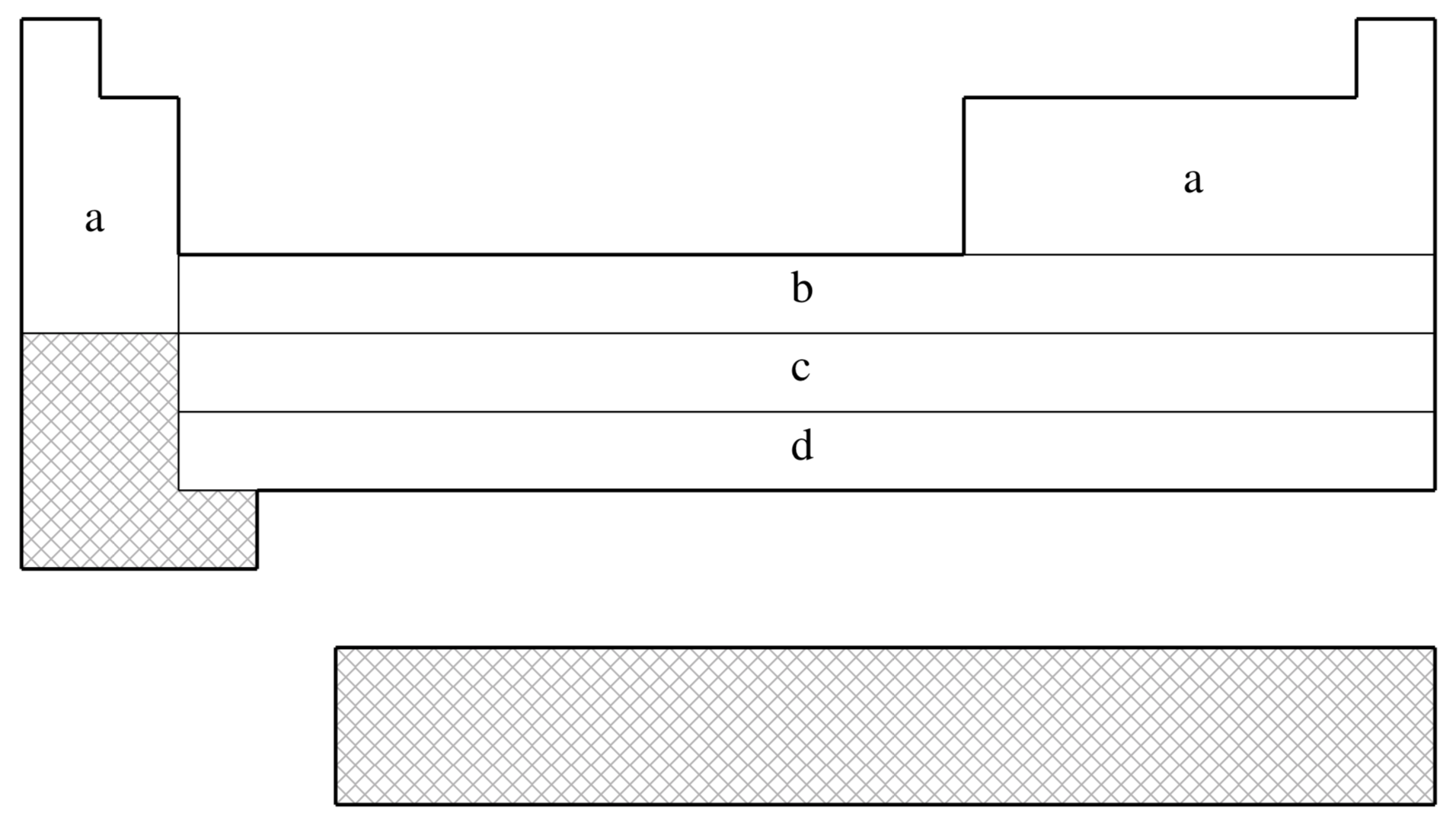

8.10.4.4 The fit-SBKJC ECP
fit-SBKJC is not available for shaded elements
(a) No ECP; Pople 3-21G basis used
(b) Stevens, Basch, & M. Krauss (Ref.  1223 Stevens W. J., Basch H., Krauss M.
J. Chem. Phys.
(1984), 81, pp. 6026.
Link
(c) Stevens, Krauss, Basch, & Jasien (Ref.  1224 Stevens W. J. et al.
Can. J. Chem.
(1992), 70, pp. 612.
Link
(d) Cundari & Stevens (Ref.  274 Cundari T. R., Stevens W. J.
J. Chem. Phys.
(1993), 98, pp. 5555.
Link
H–He none none (2s)
Li–Ne [He] S (2s,2p)
K–Ca [Ar] P (2s,2p)
Sc–Ga [Ne] P (4s,4p,3d)
Ge–Kr [Ar]+3d D (2s,2p)
Rb–Sr [Kr] D (2s,2p)
Y–In [Ar]+3d D (4s,4p,3d)
Sn–Xe [Kr]+4d D (2s,2p)
Cs–Ba [Xe] D (2s,2p)
La [Kr]+4d F (4s,4p,3d)
Ce–Lu [Kr]+4d D (4s,4p,1d,1f)
Hf–Tl [Kr]+4d+4f F (4s,4p,3d)
Pb–Rn [Xe]+4f+5d F (2s,2p)
Table 8.12: Supported elements for the fit-SBKJC ECP.

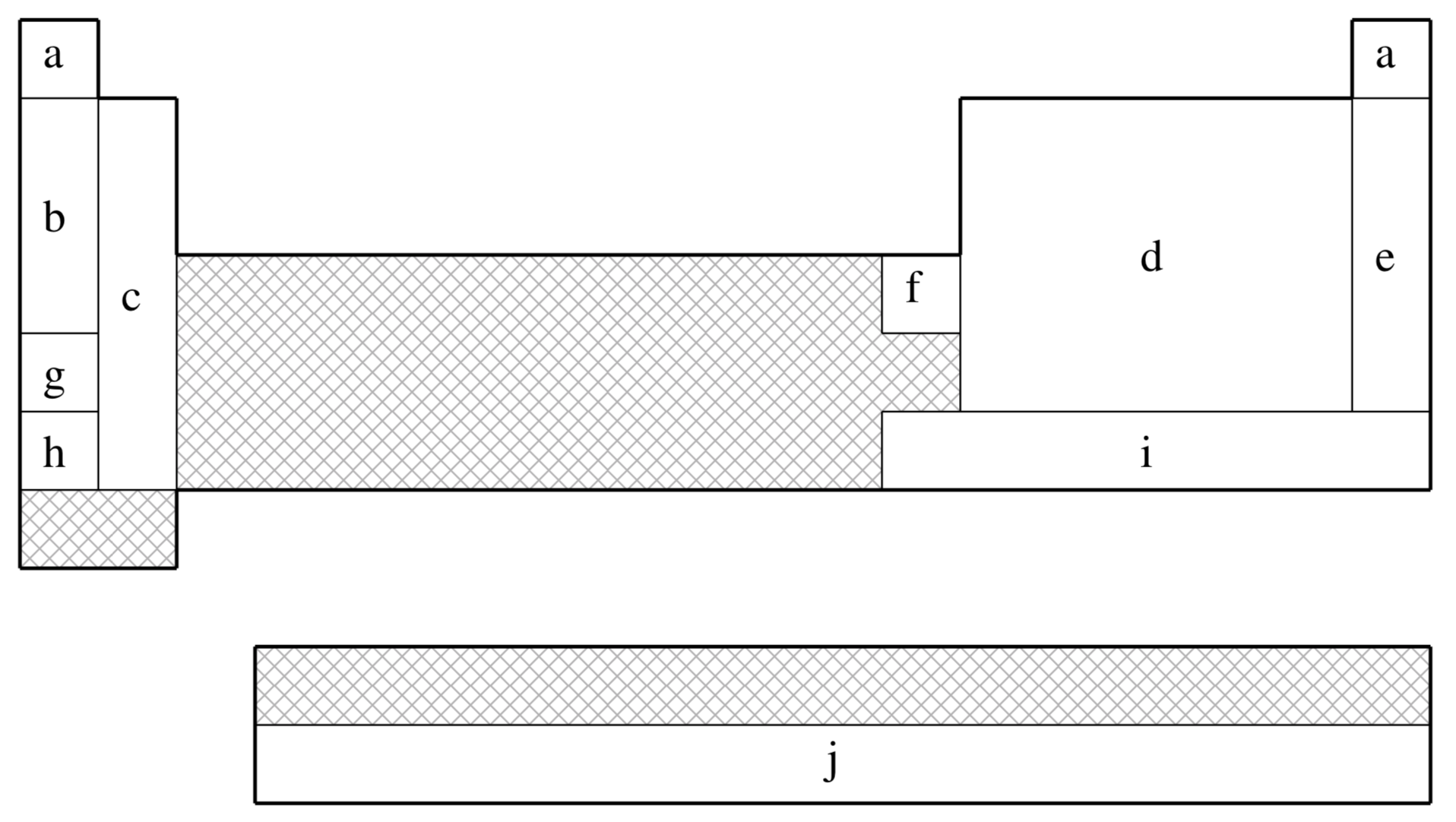

8.10.4.5 The fit-CRENBS ECP
fit-CRENBS is not available for shaded elements
(b) Hurley, Pacios, Christiansen, Ross, & Ermler (Ref.  570 Hurley M. M., Pacios L. F., Christiansen P. A.
J. Chem. Phys.
(1986), 84, pp. 6840.
Link
(c) LaJohn, Christiansen, Ross, Atashroo & Ermler (Ref.  706 LaJohn L. A. et al.
J. Chem. Phys.
(1987), 87, pp. 2812.
Link
(d) Ross, Powers, Atashroo, Ermler, LaJohn & Christiansen (Ref.  1107 Ross R. B. et al.
J. Chem. Phys.
(1990), 93, pp. 6654.
Link
(e) Nash, Bursten, & Ermler (Ref.  920 Nash C. S., Bursten B. E., Ermler W. C.
J. Chem. Phys.
(1997), 106, pp. 5133.
Link
H–He none none (1s)
Na–Ar none none (3s,2p)
K–Ca none none (4s,3p)
Sc–Zn [Ar] P (1s,0p,1d)
Y–Cd [Kr] D (1s,1p,1d)
La [Xe] D (1s,1p,1d)
Hf–Hg [Xe]+4f F (1s,1p,1d)
Tl–Rn [Xe]+4f+5d F (1s,1p)
Table 8.13: Supported elements for the fit-CRENBS ECP.

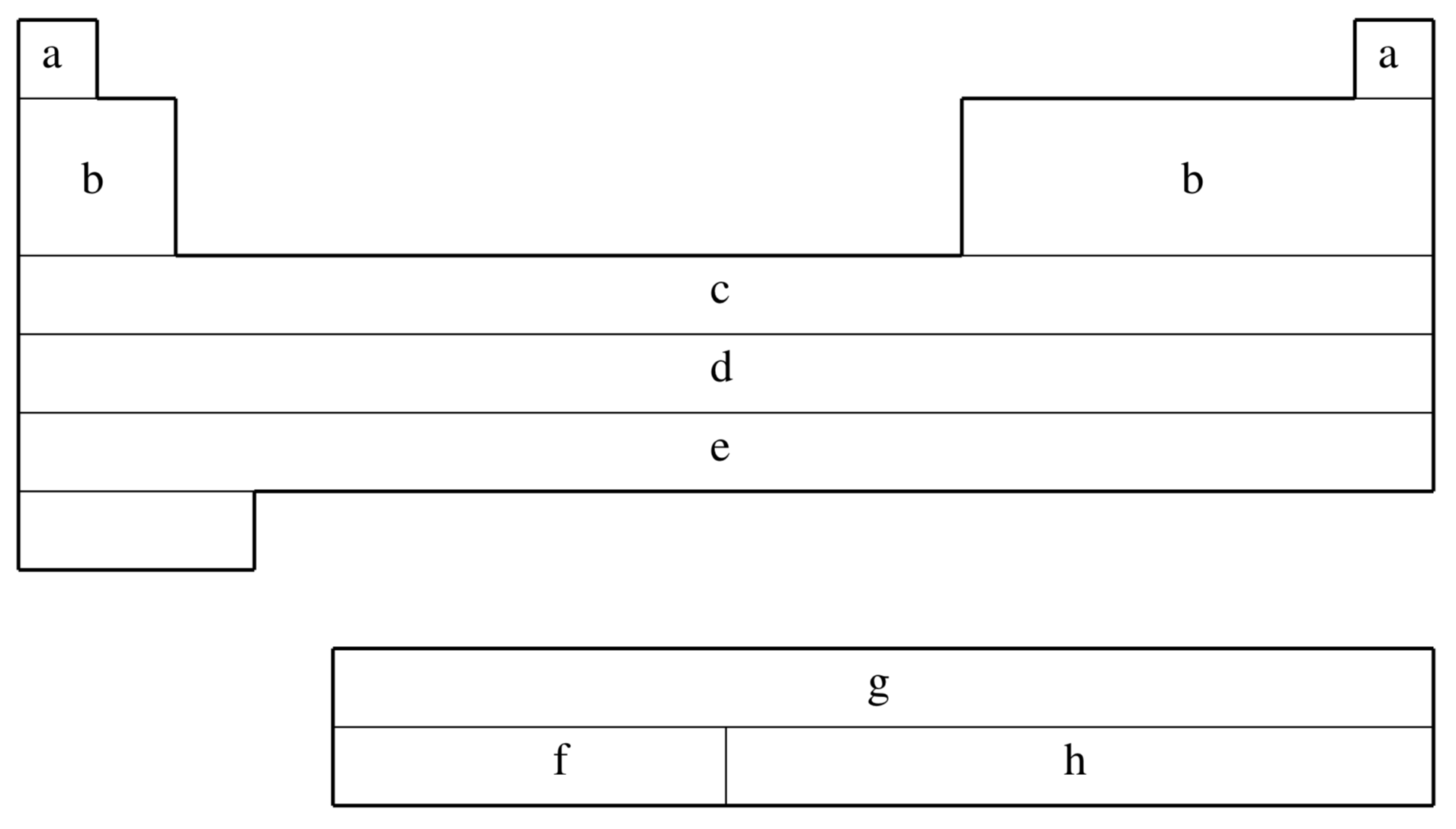

8.10.4.6 The fit-CRENBL ECP
(a) No ECP; Pople 6-311G basis used
(b) Pacios & Christiansen (Ref.  963 Pacios L. F., Christiansen P. A.
J. Chem. Phys.
(1985), 82, pp. 2664.
Link
(c) Hurley, Pacios, Christiansen, Ross, & Ermler (Ref.  570 Hurley M. M., Pacios L. F., Christiansen P. A.
J. Chem. Phys.
Link
(d) LaJohn, Christiansen, Ross, Atashroo, & Ermler (Ref.  706 LaJohn L. A. et al.
J. Chem. Phys.
Link
(e) Ross, Powers, Atashroo, Ermler, LaJohn, & Christiansen (Ref.  1107 Ross R. B. et al.
J. Chem. Phys.
Link
(f) Ermler, Ross, & Christiansen (Ref.  348 Ermler W. C., Ross R. B., Christiansen P. A.
Int. J. Quantum Chem.
(1991), 40, pp. 829.
Link
(g) Ross, Gayen, & Ermler (Ref.  1106 Ross R. B., Gayen S., Ermler W. C.
J. Chem. Phys.
(1994), 100, pp. 8145.
Link
(h) Nash, Bursten, & Ermler (Ref.  920 Nash C. S., Bursten B. E., Ermler W. C.
J. Chem. Phys.
Link
H–He none none (3s)
Li–Ne [He] S (4s,4p)
Na–Mg [He] S (6s,4p)
Al–Ar [Ne] P (4s,4p)
K–Ca [Ne] P (5s,4p)
Sc–Zn [Ne] P (7s,6p,6d)
Ga–Kr [Ar] P (3s,3p,4d)
Rb–Sr [Ar]+3d D (5s,5p)
Y–Cd [Ar]+3d D (5s,5p,4d)
In–Xe [Kr] D (3s,3p,4d)
Cs–La [Kr]+4d D (5s,5p,4d)
Ce–Lu [Xe] D (6s,6p,6d,6f)
Hf–Hg [Kr]+4d+4f F (5s,5p,4d)
Tl–Rn [Xe]+4f F (3s,3p,4d)
Fr–Ra [Xe]+4f+5d F (5s,5p,4d)
Ac–Pu [Xe]+4f+5d F (5s,5p,4d,4f)
Am–Lr [Xe]+4f+5d F (0s,2p,6d,5f)
Table 8.14: Supported elements for the fit-CRENBL ECP.

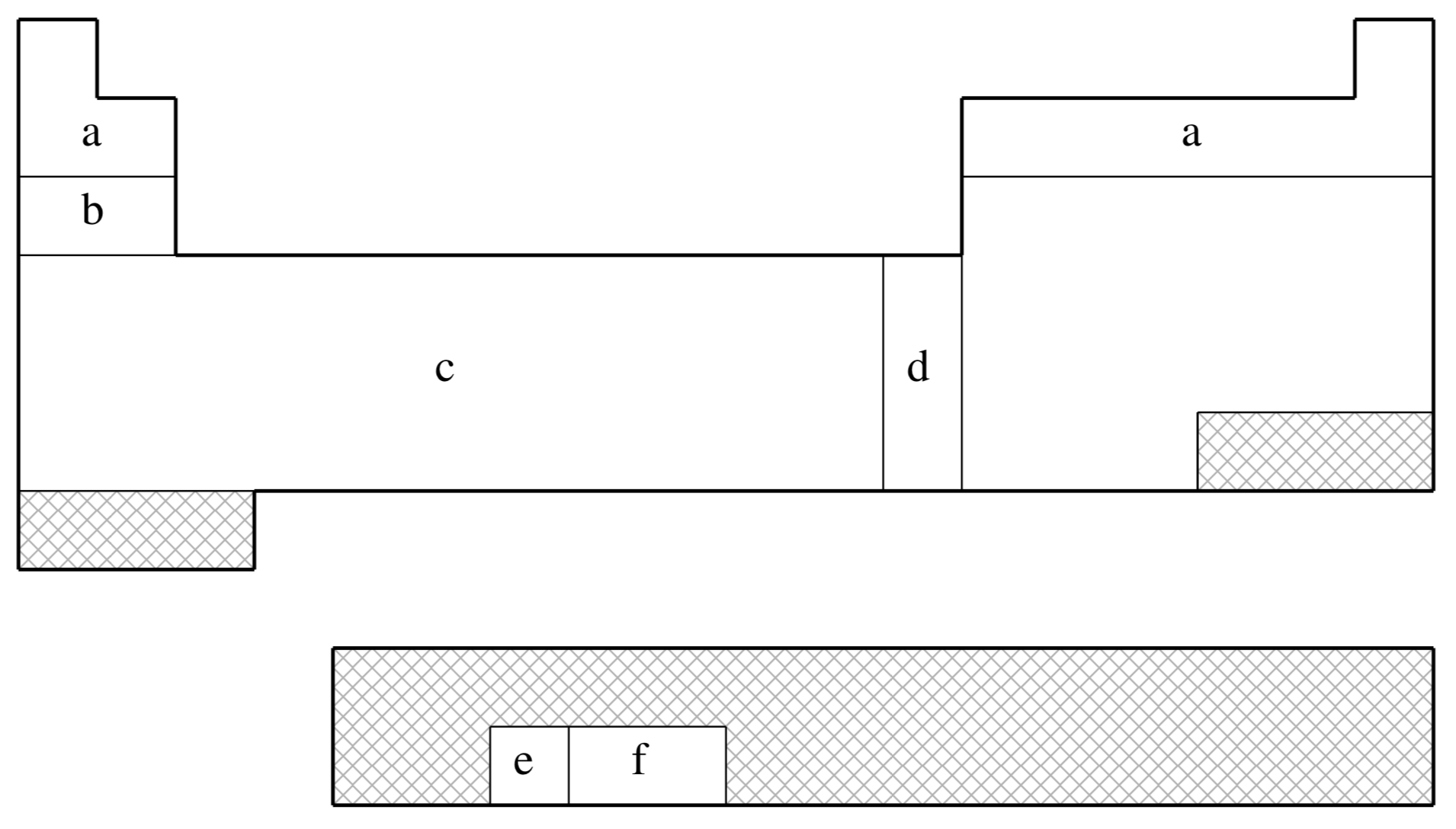

8.10.4.7 The SRLC ECP
SRLC is not available for shaded elements
(b) Fuentealba, Preuss, Stoll, & von Szentpály (Ref.  383 Fuentealba P. et al.
Chem. Phys. Lett.
(1982), 89, pp. 418.
Link
(c) Fuentealba, von Szentpály, Preuss, & Stoll (Ref.  385 Fuentealba P. et al.
J. Phys. B: At. Mol. Opt. Phys.
(1985), 18, pp. 1287.
Link
(d) Bergner, Dolg, Küchle, Stoll, & Preuss (Ref.  106 Bergner A. et al.
Mol. Phys.
(1993), 80, pp. 1431.
Link
(e) Nicklass, Dolg, Stoll, & Preuss, (Ref.  927 Nicklass A. et al.
J. Chem. Phys.
(1995), 102, pp. 8942.
Link
(f) Schautz, Flad, & Dolg (Ref.  1125 Schautz F., Flad H.-J., Dolg M.
Theor. Chem. Acc.
(1998), 99, pp. 231.
Link
(g) Fuentealba, Stoll, von Szentpály, Schwerdtfeger, & Preuss (Ref.  384 Fuentealba P. et al.
(1983), 16, pp. L323.
Link
(h) von Szentpály, Fuentealba, Preuss, & Stoll (Ref.  1313 von Szentpály L. et al.
Chem. Phys. Lett.
(1982), 93, pp. 555.
Link
(i) Küchle, Dolg, Stoll, & Preuss (Ref.  694 Küchle W. et al.
Mol. Phys.
(1991), 74, pp. 1245.
Link
(j) Küchle (Ref.  )
H–He none none (2s)
Li–Be [He] P (2s,2p)
B–N [He] D (2s,2p)
O–F [He] D (2s,3p)
Ne [He] D (4s,4p,3d,1f)
Na–P [Ne] D (2s,2p)
S–Cl [Ne] D (2s,3p)
Ar [Ne] F (4s,4p,3d,1f)
K–Ca [Ar] D (2s,2p)
Zn [Ar]+3d D (3s,2p)
Ga–As [Ar]+3d F (2s,2p)
Se–Br [Ar]+3d F (2s,3p)
Kr [Ar]+3d G (4s,4p,3d,1f)
In–Sb [Kr]+4d F (2s,2p)
Te–I [Kr]+4d F (2s,3p)
Xe [Kr]+4d G (4s,4p,3d,1f)
Hg–Bi [Xe]+4f+5d G (2s,2p,1d)
Po–At [Xe]+4f+5d G (2s,3p,1d)
Rn [Xe]+4f+5d G (2s,2p,1d)
Ac–Lr [Xe]+4f+5d G (5s,5p,4d,3f,2g)
Table 8.15: Supported elements for the SRLC ECP.
